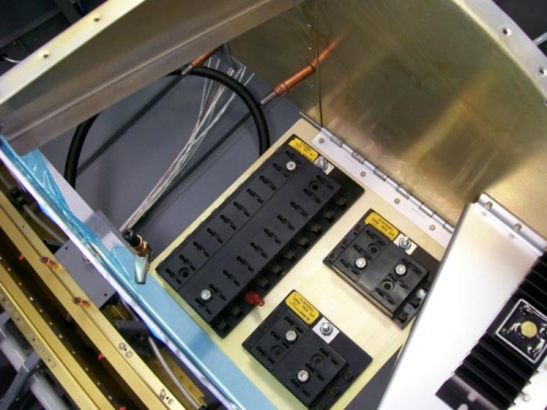

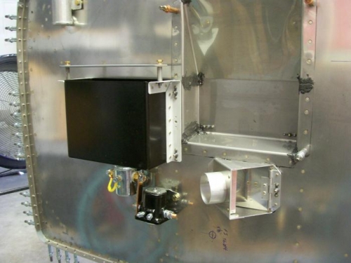

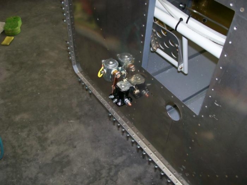

Brief Description:  Firewall forward
Worked on firewall parts. Heater valve, battery solenoid, starter solenoid, battery box and recess. After drilling holes and attaching plate nuts I attached all these parts. Then I dimpled and cleaned the recess, Prosealed and riveted. I sealed up all the cracks and holes with Proseal. Drilled hole for the heater valvs and Prosealed and bolted into place. I had stopped by Ace Hardwarere and bought stainless screws for attaching the fuse blocks. I finished up the hinged panel by drilling the hinge, Alodining and riveting into place.
