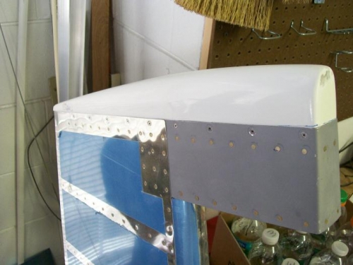

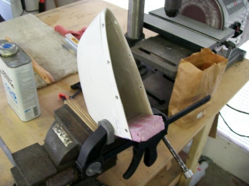

Finished sanding and fitting the rudder tip. Drilled and dimpled skins and then riveted. Cut, fit, drilled and counter sunk VS tip. Cut foam and fiberglassed in the closeout piece. More to do on the fiberglass tomorrow before riveting in place. There is work to do on the rudder bottom but it will have to wait until it is mounted and the tail spring is in place. On the tail dragger the tail spring gets in the way of the rudder bottom so there is additional cutting required.
Rudder tip
Rudder tip
