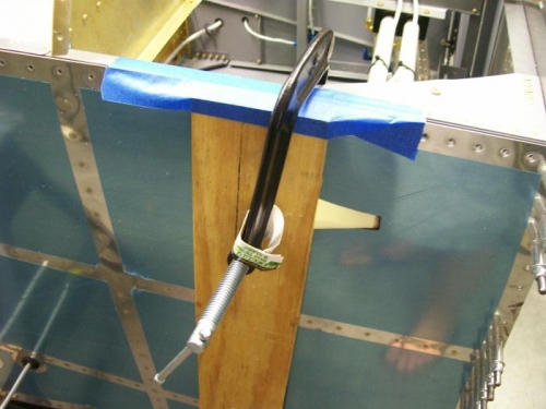

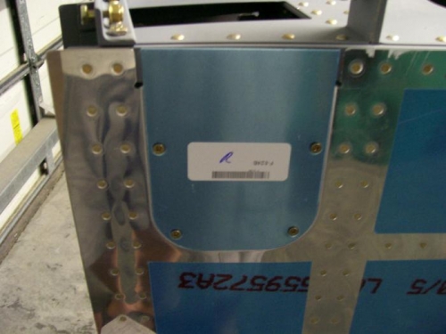

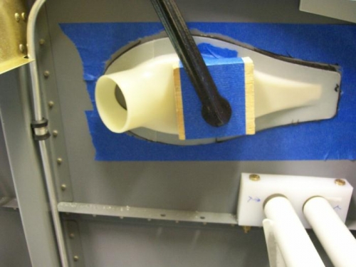

Brief Description:  Finishing up fuselage
Started the evening by deburring, de-blueing and dimpling the forward rear top skin. There are two access plates that get plate nuts and counter sunk. I did that and then installed loosely. I went to Harbor Freight today and bought a couple of 5" deep clamps. I sanded the NACA vents to roughin them up and then mixed up some Pro-seal. I glued the vents into place. Some people also add rivets but I feel the Proseal should do just fine. I took a few things to the storage area today to get them out of the way. I am now out of loose parts from the last kit.
