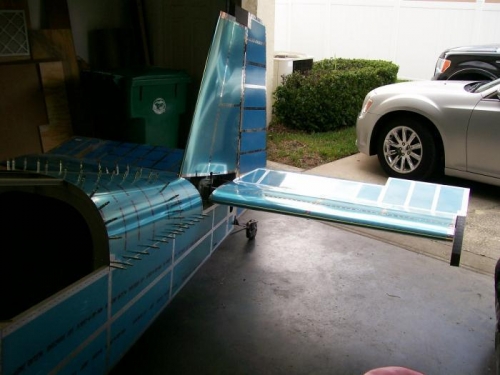

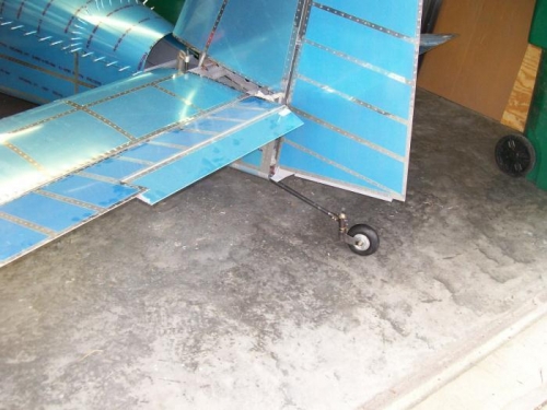

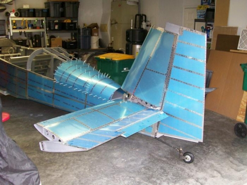

Brief Description:  Empenage mounting
Fabricated the elevator stop which is also the angle that holds the upper prortion of the VS spar. Drilled it to the rear deck. Leveled everything up measured to make sure it was straight and then dilled the rear spar to the angle. Then drilled the front spar bracket and then the bottom of the rear spar. Mounted the rudder and then made the rudder stops. I am not happy with the fit of the Left stop so I will probably remake this one. Went to the storage facility where i have the wings stored and picked up the elevators. Mounted those and drilled the horns for the pushrod. Tomorrow I will remake the rudder stops and then adjust the puhrod. I mounted the tailwheel just for the fun of it. I will get it powder coated soon. Sure looks cool. If I had the front gear on I would have rolled it around the driveway.
