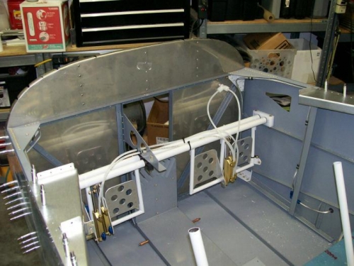

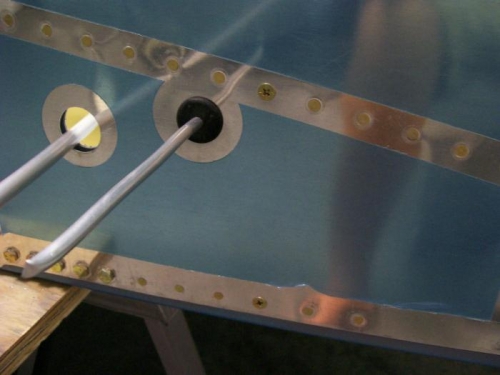

I pulled the front instrument panel supports apart and deburred, dimpled and added nut plates. These are now set aside until I can alodine them. I don't think I will prome them, just alodine. This area will not see water or much moisture and it will get scracthed badly during panel work so primer doesn't make sense. Started double checking the prints for small things that need to get done before I add the empenage. Drilled, counter sunk and torqued the screws that hold the tank brackets. Then added the last of the bolts that hold the spar carry through together.
All bare again
All bare again
Fuel tank bracket support screwed through the skin, longeron and angle with counter sunk screws
