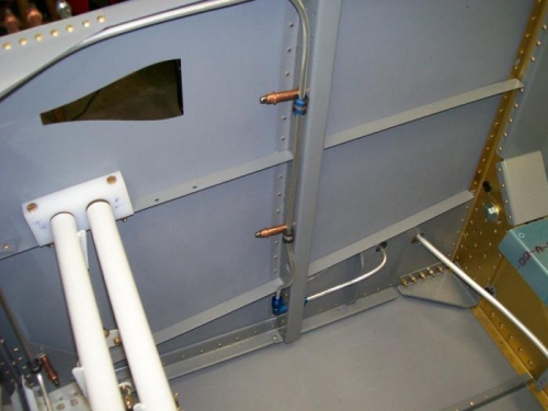

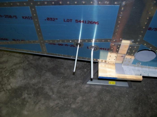

Number of Hours:  3.00
Brief Description:  Fuel & brake lines
Finished up zip tied the staic line to the F-707 bulkhead. Finished up the fuel vent line for the right side and fuel line for both sides. Started on the brake lines by pulling out all the fittings and lines. Pulled the assembly back out and added the brass fittings to the master cylinders. Re-installed the pedals and torqed the bolts. I spent time looking for the VA-118 braided hoses but gave up and checked VAF and found that they come with the finish kit.
