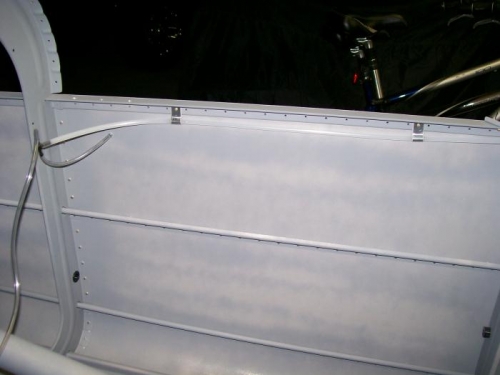

Brief Description:  Static line and forward covers

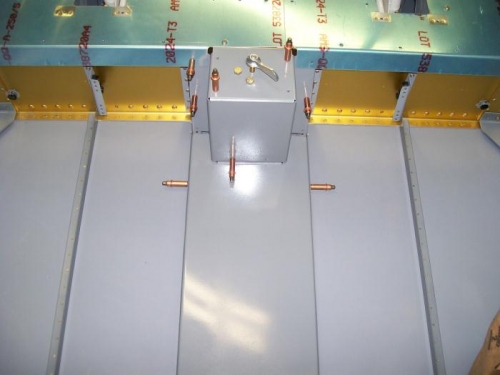

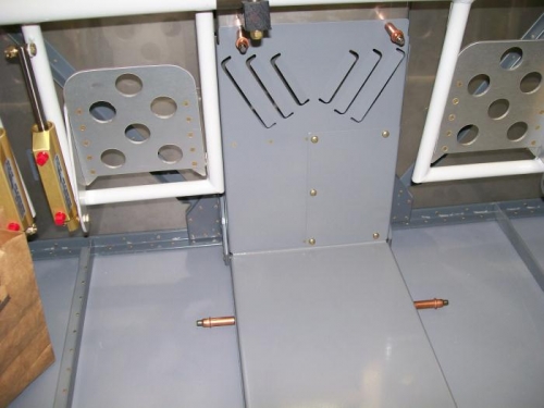

Forward covers were painted yesterday so I installed the plate nuts and clecoed the covers in place. I will need to remove soon so I won't screw them in place yet. No picture but also screwed on the electric flap side covers. Started the static line install. I don't have the correct wire ties so tidying up will wait until tomorrow. I fabricated small clips and riveted to the longeron. I ran the tubing forward to the F-705 bulkhead and then ran out of a route to get forward. I rechecked the plans to see how to get forward but no mention on drilling the F-705 bulkhead. After finishing for the evening, I checked Van's Airforce for comments on how others routed the static line. Seems Van's authorizes a small drilled hole in the F-705 bilkhead. I will do this tomorrow.
