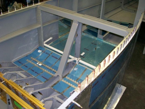

Brief Description:  Flap actuator

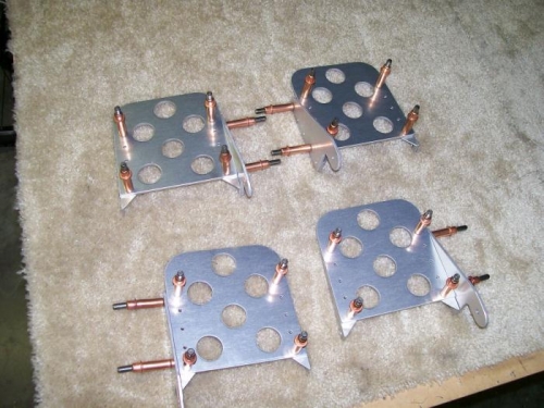

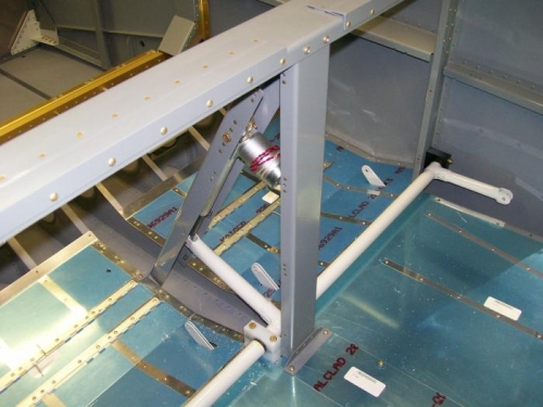

Picked up my anodizing today. I assembled he brake pedals and they are ready for riveting. Clecoed the anodized side rails on for riveting later. All the flap actuator parts were painted yesterday and are now dry so I started assembly. Riveted all the brackets on then bolted the motor in. Screwed it all in and then match drilled the side covers. Pulled the rear brace back out and added the nut plates. The flap actuator is finished. I just need to alodine and paint the side covers.
