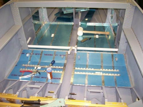

Date:  7-24-2012
Number of Hours:  2.50
Brief Description:  Flap actuator
I finished drilling a couple of parts on the flap actuator parts and then Alodined and primed. I then painted the parts that show. Removed the flap actuator bar and installed the nut plates for the center bearing. Installed the aft seat floors with blind rivets and center nut plates then reinstalled the actuator bar. Torqed the bolts for the ends and center bearing. I got a call that my Anodized parts are ready to pick up tomorrow.
