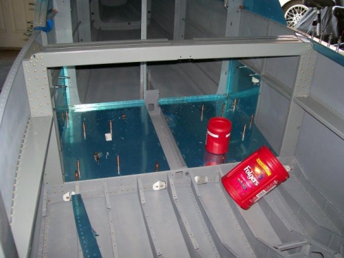

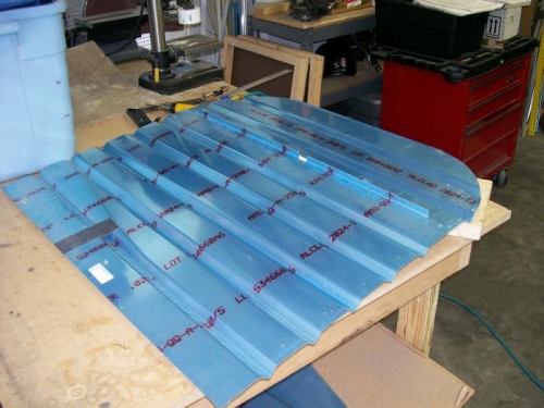

Date:  7-14-2012
Number of Hours:  2.50
Brief Description:  Cabin assembly
Time to rivet in the side baggage panel and bottom. However I have not finished riveting the bottom skin an I need these off for access. I also have not decided what I am going to do about soundproofing and electrical routing. So for now they will be clecoed so I can get other things done. Then it was time to add the baggage bulkhead. This requires some cutting to shape and drilling for nutplates. I think I will remove the forward top skin tomorrow to help with access on the platenuts that get riveted to the F-706 bulkhead.
