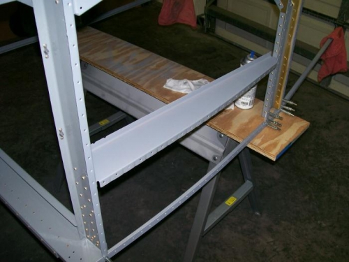

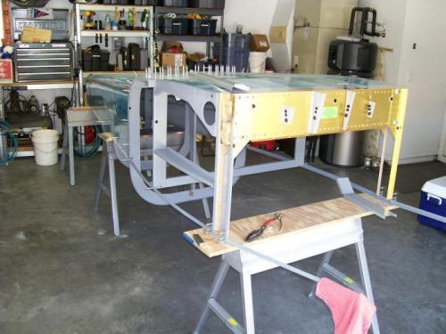

Brief Description:  Fuselage assembly
Spent time getting the center section ready for mounting to the aftt section. Deburred the bottom skin where it connects and then dimpled. Deburred and dimpled F-905 and countersunk F-904 where the side skins mount. Primed and painted the arm rests F-904-H and F-905-Z. Added nutplates to the F-915 seat ribs. Deburred and dimpled Baggage corner ribs F-683 then dimpled to bottom skins. Turned the aft section back over and connected the center section and clecoed together. Some people talk about this being difficult but this is my second time and this time was by myself and I had no problem. I will rivet the bottom skin before adding the side skins as this will allow me to do it solo.
Horizontal piece is the armrest
