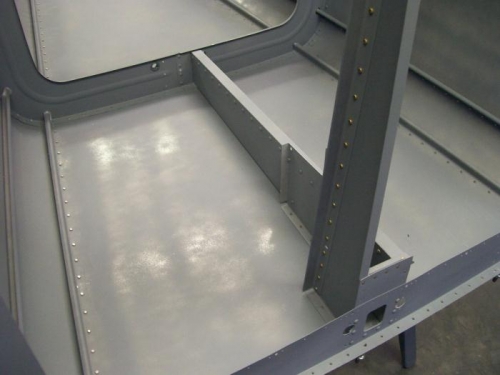

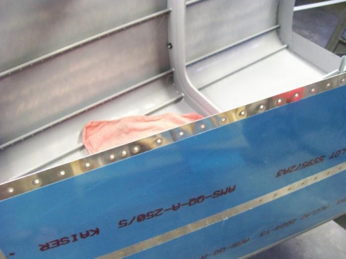

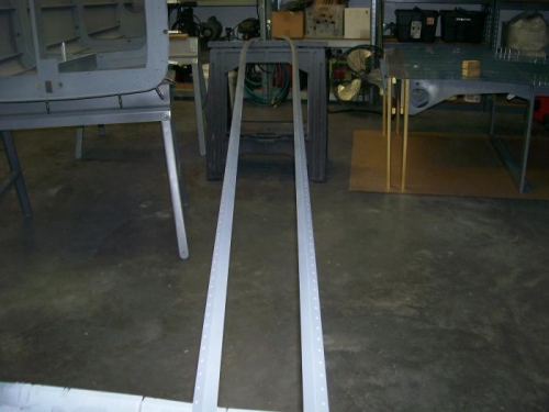

Finished countersinking longerons, alodined and then primed. Riveted the F-906 bulkhead into aft section and then deburred and dimpled the top edge of the aft section where the longerons attach. Swept the garage and then slide the longerons in place and then clecoed skins. Finished by priming a couple of parts I had clecoed before the rain set in last week.
F-906 and rib riveted into aft section
longerons alodined and primed
Aft section dimpled for lonerons
