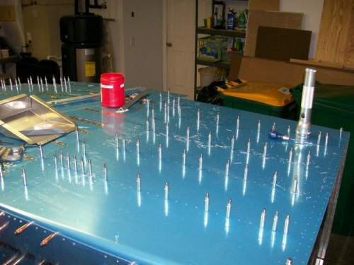

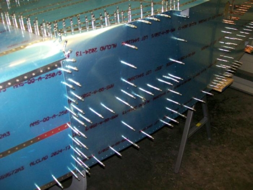

Finished up the rudder and brake pedals. I stopped by an anodizers today to check on having the brake pedals anodized. I think I will have them anodized black and then polish the lightning holes. They have a minimum charge of $75 dollars so I think I will wait and assemble a few other parts to have anodized. I then clecoed the front bottom skin on and drilled the floor stiffeners in assembly. I then clecoed the F-722 and F-724 baggage compartment bulkheads in. I have some final drilling to do in a few places and then time to pull apart for deburr, dimple and prime before riveting.
