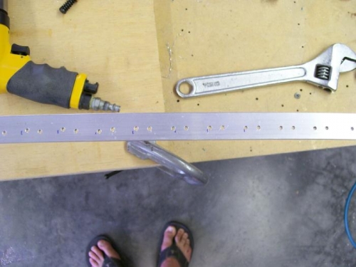

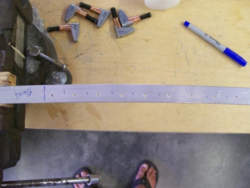

Brief Description:  Confessions of the longeron
