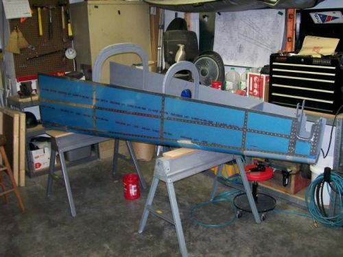

Date:  5-29-2012
Number of Hours:  3.00
Brief Description:  Aft fuselage riveting
Spent three hours jst riveting. Today started at the rear to get the hard ones around the tail cone assembly. Wasn't too bad and it came out perfect. Finished one side and most of the other. I called RV-7 Chris to see if he could come by to help with the bottom seam sometime this week. I also ordered autopilot servo mounting kits from Trutrak. The pitch servo mounts in this section of the fuse and is best to get it done now. It should arrive Fedex by Thursday.
Almost same picture as yesterday minus a bunch of clecos
