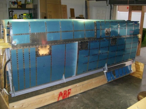

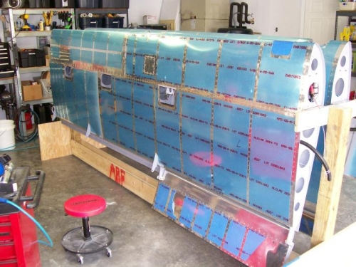

Brief Description:  Bottom wing skins
Finished skin to spar rivetes on left wing then moved to right wing. Temporarily installed bottom skins to drill flap attach angle holes. Removed skins and counter sunk new holes. Touched up primer spots and then re=installed skins. Finished skin rivets. Started on access covers. Match drilled, deburred, dimpled then riveted the platenuts. Drilled left skin for pitot fitting. Installed bulkhead fitting and attached aluminum tubing on the back side. Drilled hold down hole in leading edge skin of right wing. Installed both eye rings. After access covers are finished on right wing I will flip these back over into the wing stand and move to storage.
Left wing bottom skin complete
Right wing inboard bottom skin finished
Left wing complete with access covers, pitot and tie down ring.
