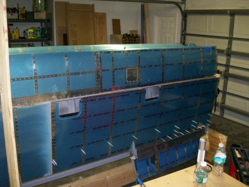

Brief Description:  Bottom skins
I didn't hear from Chris RV-7 last night or today so I am on my own with the bottom skins. It seems like blind reaching some of the inside areas would be a problem. Also I worry about the order so that they can all be reached. All the other websites kinda leave off the order. I decided to get started as it won't be long before my fuselage kit shows up and I need to get these wings in storage. It was much easier than I expected. I worked on the inboard skin at the rear spar first and moved toward the front spar about four rivets per rib at a time. When pulling the skin out for access got tight I was able to reach in through the rib access holes. Moved on to the outboard skin. I started on the rear spar and moved forward four rivets and then finished for the night.
