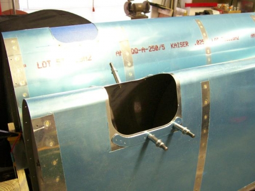

I added a bracket to the end rib of the right wing and had Marsha help me move the wing to the stand so I could get the leading edge light installed. Started installing the light. Cut a hole in the leading edge using my Dremel. Trimmed up the edges using a file and then the Scotchbrite wheel on the air grinder. Installed the nut plates on the ribs to hold the internal bracket.

Leading edge cut and finished
