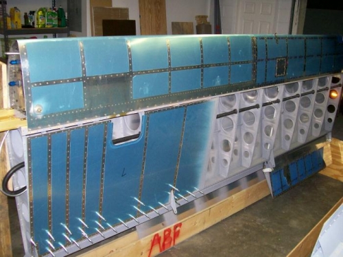

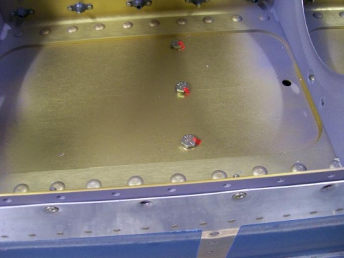

Mostly busy work. Worked to get the left wing ready for bottom skins to be riveted on. Torqued the tank bolts that run through the spar and bellcrank mounting bolts. Tightened all the tank skin screws. Put Torque Seal on all the bolts that were torqued. This doesn't keep the bolts or nuts from coming loose but it is an indicator if the do break loose. Removed the flap as it is required to get the skins on. Temp. mounted the skins to drill a couple of angles that were added with the flap brackets. Removed the skins again and countersunk the new holes. Spray primer touched up all areas that had gotten scratched or drilled. Hung inboard skin and now it is ready for riveting. Torqued the bolts in the right wing and added Torque Seal. Ground the flap hinge bracket bushings to the correct width. They come .250" wide but need to be ground or filed to ,156". I need to get the right wing on the stand so I can get the Duckworks leading edge light installed next.
Left wing ready for bottom skin riveting.
Note small 10-32 bolts with orange torque Seal
