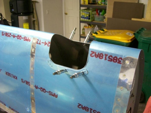

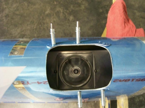

Brief Description:  Landing light
Cleaned and primed the flap spar and skins. I received my new Duckworks landing and taxi lights from Van's. I re-assembled the old wing stand to hold the wings while I install the leading edge lights. RV-7 Chris came by to help me move the left wing to the stand. I had to remove the aileron control rod to mount it on the stand. It had to come out to rivet the bottom skin anyway. I then started on the light. Cut the slot in the leasding edge, cut, shortened and riveted the bracket back together. Drilled the ribs and mounted the nut plates that hold the bracket. mounted the power supply to the outer rib so that it can be acsessed through the wing tip.
