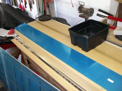

Date:  4-8-2012
Number of Hours:  2.50
Brief Description:  Right flap
Ran pitot tube in Left wing. Inserted grommets in each rib and then ran the 1/4" aluminum tubing from the root to the fitting. Flared the end at the fitting and rolled up the root end for storage. I used a vacuum to pull a pull string through the conduit. Also pulled the wire for the electric stall indicator through the conduit. Clecoed the leading edge skins on the right flap. Match drilled all the holes. Dissassembled the flap for deburring, dimpling and priming.
Assembled right flap
