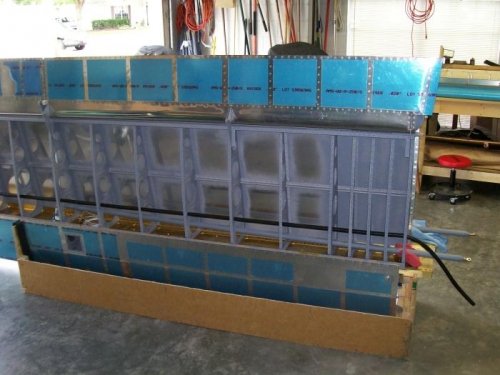

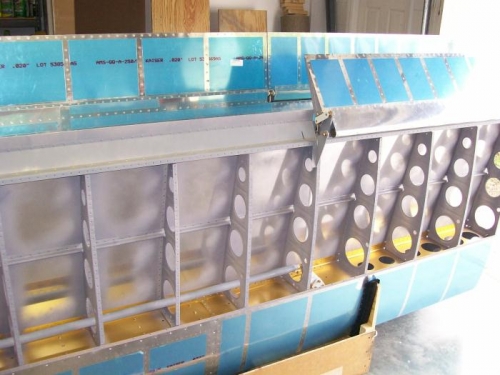

Put the ends in the long aileron pushrods and installed in wings. Ran conduit in left wing. The Proseal has been setting up in the left flap trailing edge for a week now so I removed it from the bench and back-riveted the trailing edge. hen mounted it on the wing. Adjusted all of the control rods to properly align aileron. Left flap and aileron line up nicely and are straight.
Right wing with all control rods
Left wing with flap, conduit and all control rods
