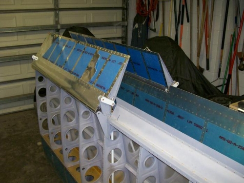

Brief Description:  Left aileron
Worked on the left aileron. When I went to attach the aileron hinge brackets I found that Vans had shipped 2 right side hinges and no left. I received the new left bracket and mounted it and then installed the left aileron on the wing. Attached the control rods. I removed the control rod for the right aileron and reamed the rod hole out larger as it was rubbing during aileron extreme movement. I will need to do the same with the left side.
Both ailerons mounted
