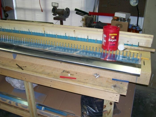

Brief Description:  Left flap and control rods
Spent Wednesday and Thursday at Sun-N-Fun in Lakeland. The weather was perfect and I got to see a ton of RV's.
Back to work on the plane and finished riveting the left flap. Riveted the top skin to spar then top skin to ribs. Added the bottom skin and riveted it to the spar. Then pop riveted the skin to the ribs. Counter sunk all of the holes in the trailiong edge wedge. Prosealed the wedge and then clecoed the flap trailing edge to the table. I will let this dry for a couple of days and then rivet it. While doing this work I spay primed the control tubes. I riveted the ends on the short tubes and one end of the long tubes.
Left flap with the trailing edge Prosealed and clecoed to the table to dry.

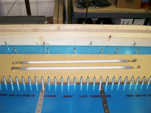

small pushrods that run from the bellcrank to the aileron

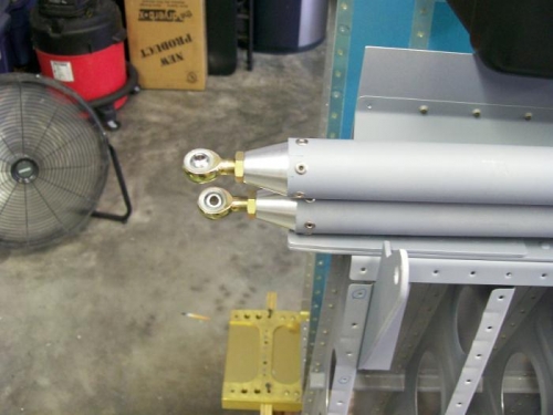

Aileron push rods that run the length of the wing
