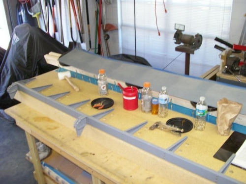

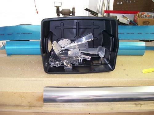

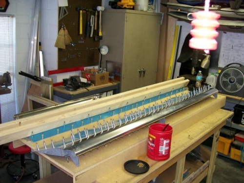

No work yesterday as I got more time in the Citabria. Pattern work with 12 take off and landings. About six knots crosswind with both wheel landings and three pointers. Still don't feel like I am in control of the Citabria it still tends to control me but things are geting better. While waiting for help on the right flap leading edges I went back to the Left flap. Flap was already match drilled and ready for disassembly. So I started disassembly, deburred, dimpled and primed. Assembled the skeleton with nose ribs, hinge brackets, spacers and spar. Added F906A. B and C. Then riveted the main ribs. Clecoed on the top skin and nose skins. Drilled the nose rib to skin holes to 7/64" and added pop rivets. Then finished off the the end ribs with solid rivets.
Left flap parts deburred

Left flap assembled with front skins
