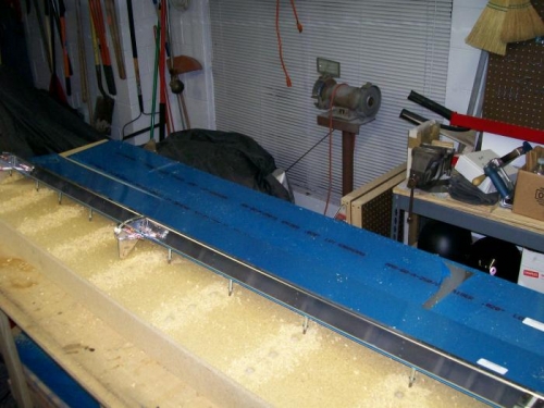

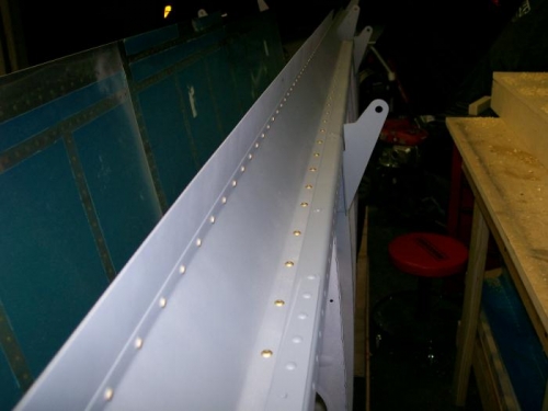

Brief Description:  Flap & aileron gap fairing pls flap
Gap fairing were finished and ready for final riveting. Did all wing skin to gap fairing rivets then fairing to spar. Match drilled all nose rib, flap spar, hinge bracket and spacers. Then fabricated F906A angle and F906C spacer. Clecoed the left flap bottom skin to the spar and then directly to the table. Removed from the table and then drilled the table cleco holes larger. This will allow me to cleco the assembly together and lay it flat on the table with the clecos down through the holes so the skin can lay flat. I worked on the left side only, tomorrow the right side.
