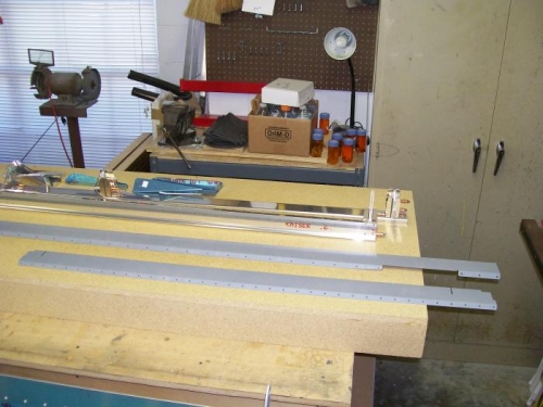

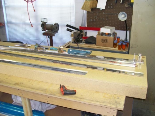

Completed flap table and screwed to the top of my existing table. Checked for flat and it is withing .020". Finished up flap hinges by riveting hinge braqcket in place and then riveting the angle braces. Clecoed gap fairings and match drilled. Removed and deburred holes, dimpled and deburred all edges. Cleaned with MEK and primed. They are ready for riveting.
Flap and aileron hinges finished
Gap fairings match drilled and on top of new temporary flap table top.
Gap fairings primed and ready for riveting
