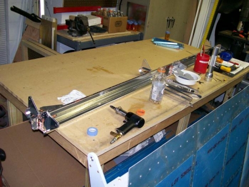

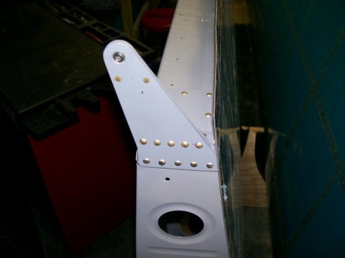

Started mounting wing hinges. Riveted the aileron brackets and then clecoed the flap brackets and match drilled re-enforcement angles. Removed plastic from flap nose ribs, hinge brackets, spacers and spars. Clecoed them all together for match drilling.
left and right flap spar with nose ribs and hinges
right wing outboard aileron hinge
