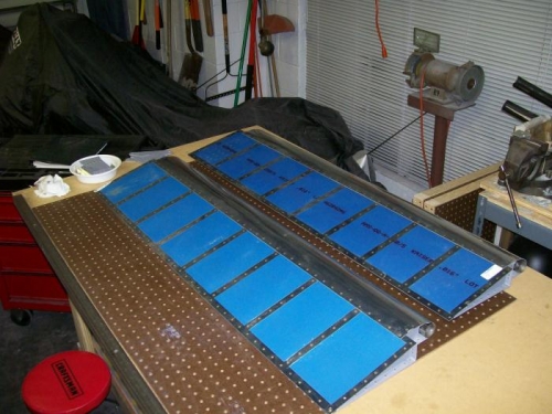

Brief Description:  Ailerons

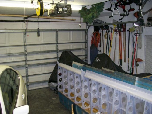

After two days I pulled all of the clecoes out of the trailing edge and cleaned up the trailing edge. I figured after two days the Proseal would be mostly dry and It would stay straight. Some areas pulled loose and the trailing edge was very wavey. Since the instructions say you can rivet without sealer I figured I would rivet the way it was. I back-riveted the trailing edge after weighing it down straight again and it came out perfect and straight. I was a little worried but now am very happy with the results. Many builders comment that they have to remake the ailerons due to a wavey edge. Without the jig assembled in the garage I had room to move the wing stand over and made room for Marsha's car back in the garage.
