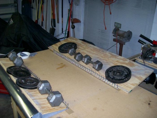

Had Chris (RV-7) come by and help finish the top skin. We riveted the J-stringer and then flipped it over onto the stand. From there we riveted the top skin to rear spar. Later I disassembled the jig and stored it out of the way in case I need it again later. I removed the clecoes from the table holding the ailerons down, I Prosealed the trailing edge and then re-clecoed the trailing edge down. I put a strip of slick packing tape down on the table along the rivet line so the Proseal would not stick the aileron down to the table. Piled weights on top to hold it straight. I will come back in a couple of days and rivet the trailing edge.
