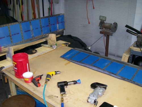

Number of Hours:  1.75
Brief Description:  Ailerons
