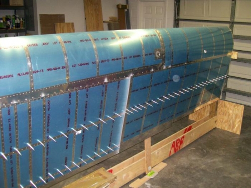

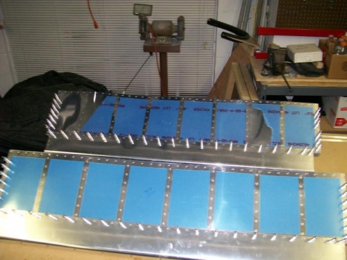

Worked on aileron nose skins.Deburred, dimpled cleaned and primed. Clecoed the nose skins on to the ailerons. We finished dinner and then Marsha helped rivet more wing skin rivets. Tonight we tackled the top skin to spar rivets. Finished that and Marsha gave up for the night. I went back to the ailerons and riveted the nose skin to the nose ribs. Then used pull rivets to attach the skin to the counter balance tube.
Right wing with top skins on and only J-stringer and rear spar left to rivet
