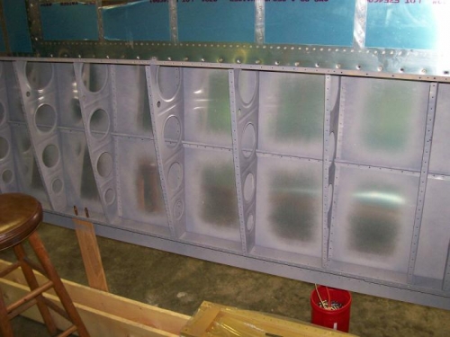

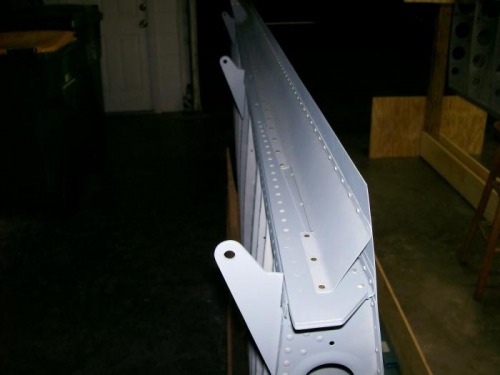

I didn't have a rivet partner tonight so I had a few other things to work on. I deburred the edges of the gap fairings. Dimpled the proper holes along the upper skin. Cleaned with MEK and then primed. Riveted both in place. J-stringers had been edeburred and dimpled before. Tonight I deburred the edges of the stringers, cleaned and primed. I then clecoed them in place.
This picture shows the left wing with the aileron and flap gap fairing installed
This picture shows the J-stringer installed in the right wing
