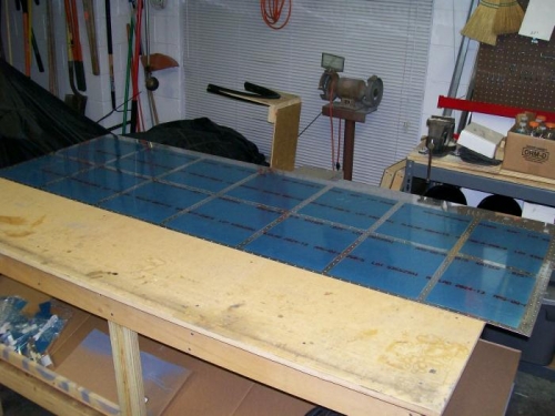

Brief Description:  Tank and top skins
Deburred holes and edges. Dimpled top outboard skin. Top outboard skin is now ready for primer but it was raining tonight and I don't paint in the rain. When Marsha got home from work I taught her how to use the rivet gun for #4 standard rivets. We finished the leading edge. The middle rib could not be access by myself so we finished that. The tank held pressure so I consider it leak free. I bolted it to the spar for good. I also clecoed the inboard top skin with the doubler.
The right wing is now ready for top skin riveting. I will need to find a rivet partner for a few hours before I can get this done.
