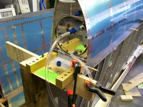

Brief Description:  Tank and top skins

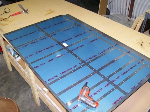

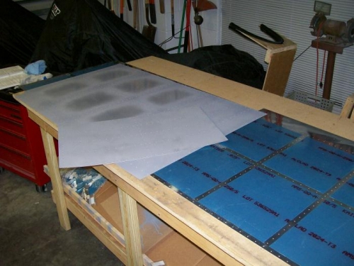

Installed access cover on tank using allen head screws instead of the phillips screws in the kit. This will get me better service later when the wing is in place. I then clecoed the tank to the spar and attached a vinyl hose. I filled the hose with water and then added pressure to the tank. This shows the pressure you have added in inches of waer pressure. Looking very good so far. Started removing plastic, deburring and dimpling top skins. I finished the inboard and doubler and primed. I then got the plastic removed on the outboard skin.
