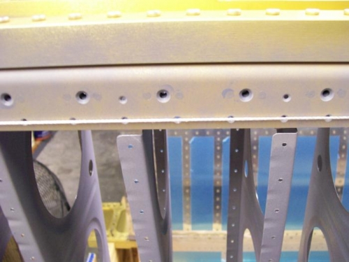

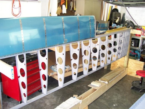

Tank and ribs work
Worked on getting the tank ready for the rear baffle seal. Installed end ribs, capacitance fuel level senders and vent. Deburred ribs and dimpled. Counter sunk spar for skin attach holes. Spar is now ready for the tank and skins.
