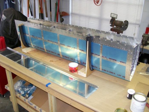

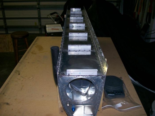

Brief Description:  Tank baffle
Tank is ready for installing rear baffle and attach angles. Mixed sealer and started installing baffle. Clecoed skin to baffle and attach angles to rear. Riveted one at a time taking about 2 hours. Then cleanng up the mess. I will let it set for a couple of days while I let the sealer set. Then I will pressure test before installing on the spar.
Tank baffle is installed and sealed
Tank ready for baffle
