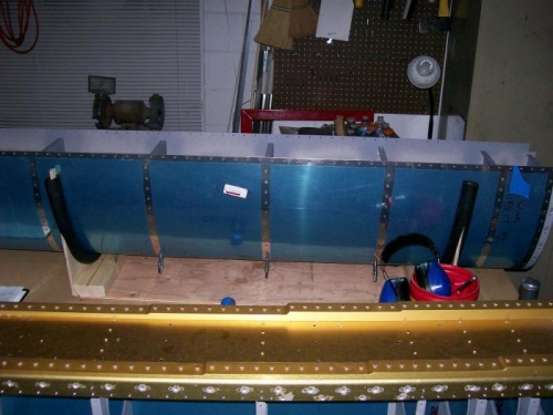

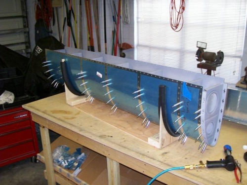

Mixed up thet last of my Pro Seal or also known as Black Death to work on the tank. I removed the clecos one at a time and then wet riveted the ribs in. I added a blob of sealant to the shop head of all rivets and then ran out of sealer. I have more on order but it will be a few more days. I started work on the spar to get ready fro the leading edge and tank by countersinking the spar. Then I removed the leading edge and disassembled. I removed vinyl, deburred and dimpled the skin. Deburred and dimpled the ribs. Cleaned and primed all parts including splice strip. Drilled and dimpled splice strip for plate nuts. Clecoed leading edge assembly together and started riveting. Halfway finished but will need to finish tomorrow.
One side of leading edge riveted
