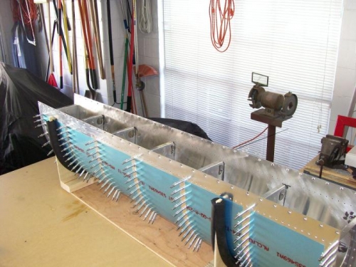

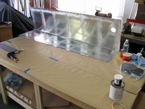

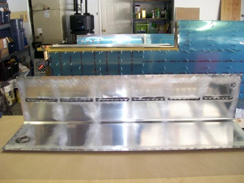

More tank work. Finished deburring then dimpled tank skin. Took all parts outside and scrubbed with a scotchbtite pad and soapy water. While waiting for it to dry I deburred the bottom side of the wing ribs and the J stringers. Cleaned everything with MEK. Mixed up a batch of tank sealer and riveted the filler cap, drain fitting and stiffeners. Mixed up a much larger batch and clecoed in all inboard ribs. It will now sit for a day or two and then I will rivet in these ribs.
Tank skin and parts all washed and cleaned with MEK
Tank with stiffeners, drain fitting and filler cap installed
Tank is assembled and sealed with the inboard ribs
