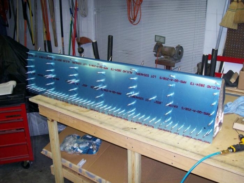

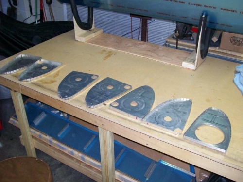

Work on the R. Tank
Start work on tank. Deburr ribs and cleco into skin. Cleco in rear baffle and temp. attach rear mounting brackets. Cleco to front spar and match drill ribs and skin to spar. Remove and match drill skin to ribs and baffle.
