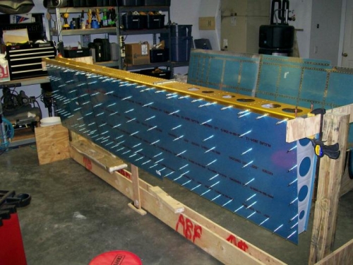

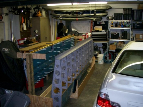

Installed R. wing skins top, bottom, inboard and outboard with inboard doubler. Clecoed in place which straightens the whole thing out. Then started match drilling all the empty holes. Then go back and move the clecos over one and then drill that hole. Every one asks about fitting it all in the garage. When I finished the empennage parts they went into the spare bedroom. Now I only have the L. wing mostly complete on the stand, the R. partial wing on the jig, 3x5 work bench, two Harleys and Marsha's BMW. Oh yeah and a few surf boards. When I get home from work I slide the stands into the middle of the garage. When I finish for the evening I slide them over and then pull the car in. I will store the wings somewhere when finished andI am hoping that I can do without the work bench and get the fuselage started even with the car in the garage. We will see.
Top side of R. wing with the skins clecoed on
Crowded work space.
Crowded work space.
