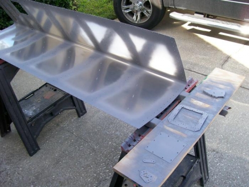

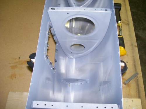

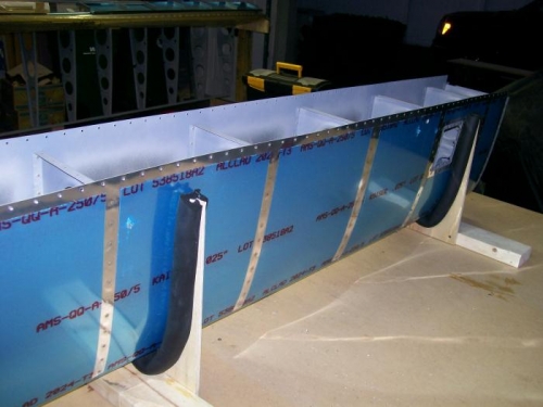

Lots of small stuff today. Counter sunk spar/skin attach points. Finished dimpling leading edge skin and primed. Built stall warning switch and deburred, counter sunk and primed. Drilled, deburred and primed splice strip and attached plate nuts. Started assembly of leading edge after building new jigs. Finished 3/4 complete riveting. Tomorrow I will finish riveting, install stall warning switch and then rivet to wing spar.
Leading edge parts primed and ready for assembly
stall warning access and mounting rib
Bottom of left leading edge is finished with only a little left on the top
