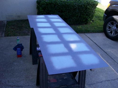

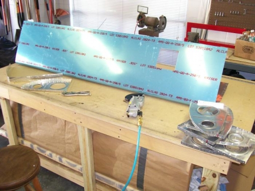

Got alot done today but nothing finished. Just lots of small stuff. Removed plastic, deburred, dimpled, sanded edges and primed outboard skin.All three top skins are now stored for later install. Dissassembled leading edge and removed plastic, deburred and dimpled. Leading edge ribs deburred, dimpled, fluted, sanded edges and primed. Wing ribs deburred and dimpled top skin side. Still have alot to do on the wing ribs and spar. I still need to deburr and dimple bottom side and counter sink alot of spar skin attach holes. Just about to finish leading edge but I keep seeing a access hole in the inboard bottom side of the skin that is not on the plans or in the instructions. The closer I am getting to closing up the leading edge the more worried i have gotten tha this part is not in the instructions. I worry that I need to do something with it before I get to far along. I looked on all of the plans sheets, read the rest of the wing instructions and even checked some others build sites. Nothing. Decided to check the packing list and found a sub-kit named Stall warning kit. Sure enough this sub-kit has three plans pages and instructions on how to install the stall warning. I will get this built before I finish prime the leading edge skin tomorrow.
Completed top outboard skin
Ribs deburred and dimpled
