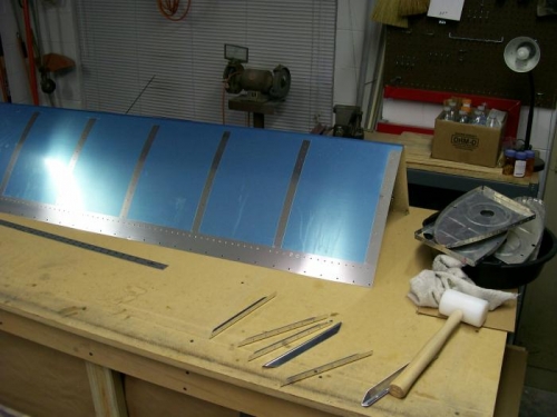

Left tank
Cleaned up access hole in end rib and added reinforcement ring with plate nuts. Deburred and dimpled tank nose ribs. Removed plastic along skin rivet line. Drilled rivet holes for fuel cap and drain fittings.
