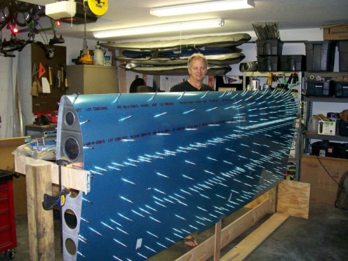

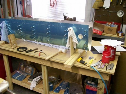

Removed tank from wing and started the rest of the tank work. Still plenty to do on the tank. Final drilled all necessary holes. Machine counter-sunk skin/baffle rivet holes, drilled mounting and strip to #19 for future dimple and #8 screws. Drilled out temporary pull rivets holding attach brackets to baffle. Clecoed nut plates to angles and drilled for rivets.
Finishing picture from last night
Left tank is now back off for work
