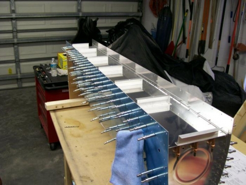

Installed ribs in tank skin, attached baffle and temporary riveted the attach angles. Installed on wing spar and match drilled attach angles to spar, drilled splice place and inboard attach angle in assembly.

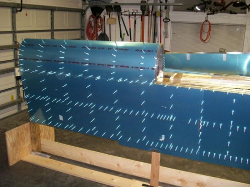

Leading edge finished and attached for match drilling
Start of tank assembly
Left tank assembly
Left tank assembly
