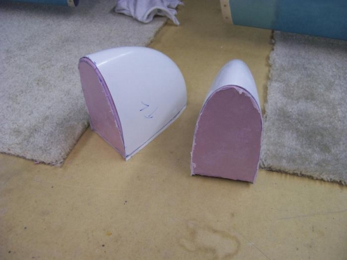

HS tips needed more work. First the tips stuck out futher than the elev. tips so there was some additional work needed. Then they are too long and the gap size and shape must be cut snd sanded. The back side of this tip is open so it must be closed somehow. I have picked one of the more common ways to do this. Cut and shaped foam to fit and will tomorrow fiberglass in the foam. Then it is sanded to shape and the outside is glassed over for the future paint. These will get glassed tomorrow.
HS tips shaped and foam cut no glass yet
