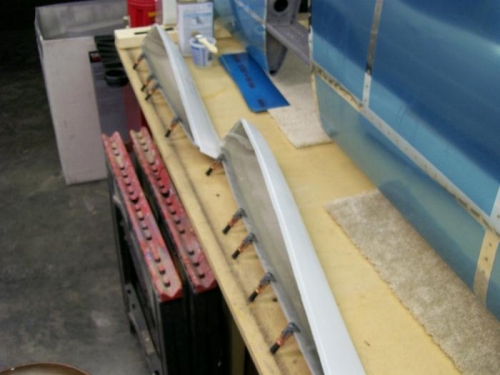

Brief Description:  Fiberglass tips
Decided that I would start the fiberglass tips while I wait for the wing kit. I bought West Systems epoxy and some sanding bars. The elevator tips fit with very little shaping. Got these shaped to fit and then glassed in a couple of strips of aluminum to reinforce the rivet strip. Will still need to add strips to the opposite side of each tip. When finished with the tip strips I will cleco these on so that I can final sand the outside shape. I will still have the HS, VS and top and bottom rudder tips to do. None of these will be riveted until the final plane assembly.
1" aluminum strip glassed along the rivet line.
