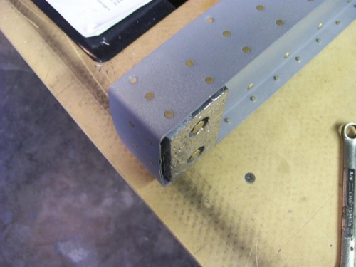

Brief Description:  Finished trim tab and L. elevator

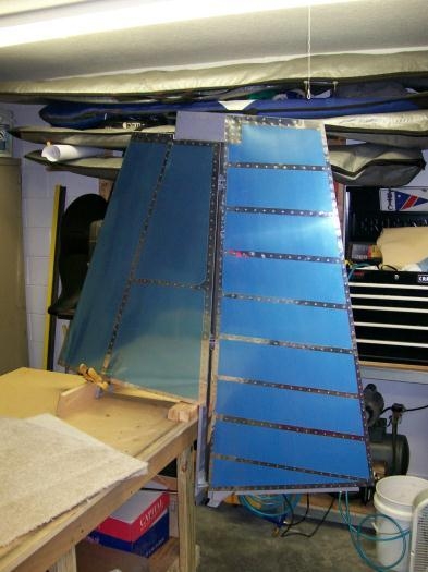

Mounted Trim servo and plate. Drilled elevator hinge in assembly and riveted. Mounted for looks and then removed so glue on the foam wedges could continue to dry. I am done with all of the emennage parts so now it is time to assemble them. I brought the rudder and VS out of storage to fit them together. Hinge line is great and the fit is perfect and straight. I looked all over the plans and instructions to find the hinge line fit and gap and then decided that they must be waiting until the VS is mounted on the Fuselage. This could cause the spar to form to the fuse and change the hinge line. Most of this assembly is for looks only. I will assemble the HS and elevators next. This hinge line can be set in advance.
L. elevator counter weights
Finished L. elevator
Proud moment. Attached rudder to VS. I now have an assembly not just a part.
