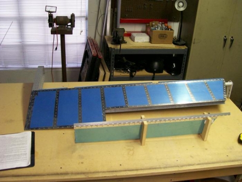

Date:  11-6-2011
Number of Hours:  6.00
Brief Description:  Finished Trim Tab and Most of L. Elevator
I assembled the trim tab, match drilled, disassembled, deburred, dimpled and primed. Drilled half of hinge to match trim tab spar. Riveted bottom of spar then glued the foam wedges in splace. Riveted the top of the skin to the spare along with the hinge half. Pulled the L. elevator off the table as the trailing edge has been Prosealed for two days. Back riveted the trailing edge and finished the last rivets on he root and tip rib. Still need to drill the other half hinge and mount trim tab and install trim servo motor.
L. elevator trailing edge done and trim tab finished
